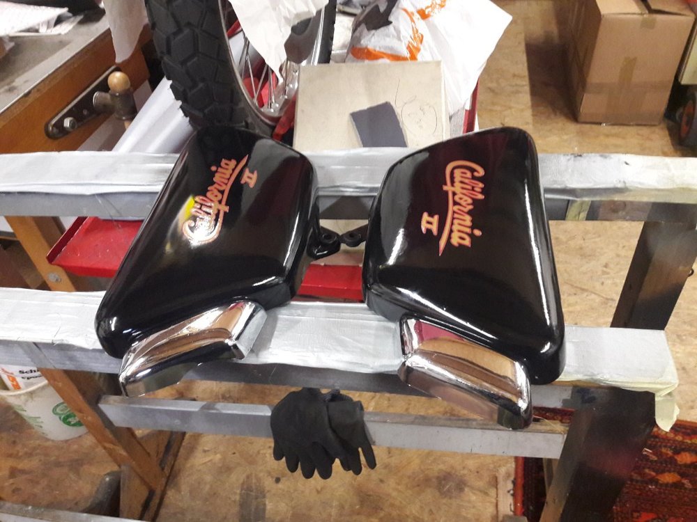

tomster1965 Posted November 1, 2021 Author Share Posted November 1, 2021 Hab endlich die chrom Schubladengriffe gekriegt. Danke nochmal an Joachim! Quote Link to comment Share on other sites More sharing options...

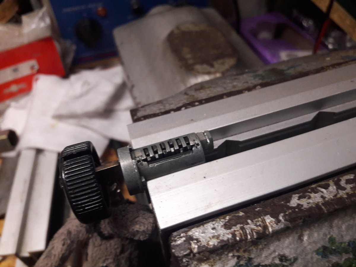

tomster1965 Posted November 1, 2021 Author Share Posted November 1, 2021 Und hab das Tankschloß umgebaut. Brauch bloß noch einen Schlüßel. Quote Link to comment Share on other sites More sharing options...

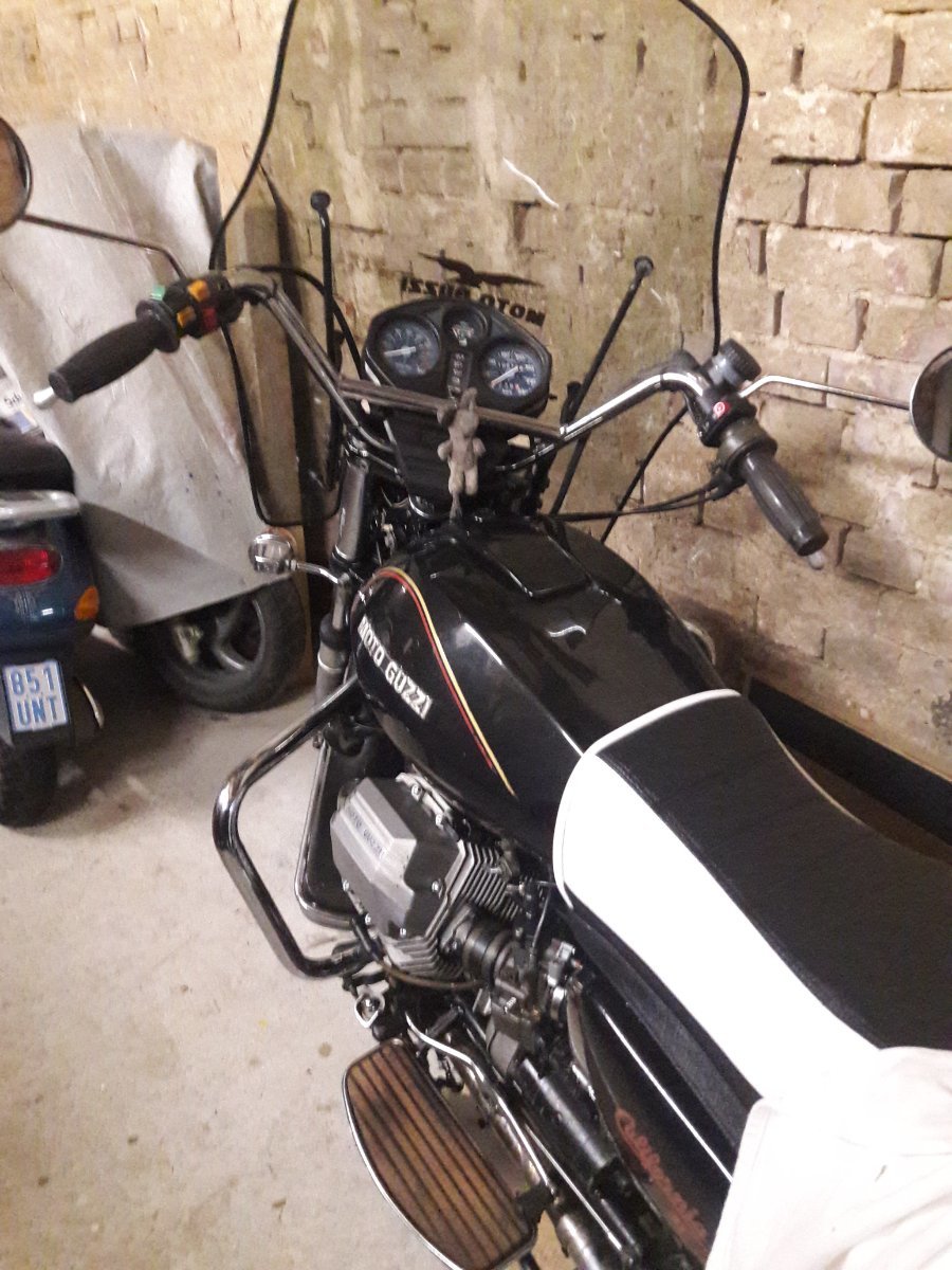

tomster1965 Posted January 13, 2022 Author Share Posted January 13, 2022 Endlich ist der häßliche Original Seilwurflenker weg. Der von der T3 sieht wesentlich besser. Quote Link to comment Share on other sites More sharing options...
Guzzi - Mann Posted January 13, 2022 Share Posted January 13, 2022 Schön geworden, Respekt 👍! Grüße Tobias Quote Link to comment Share on other sites More sharing options...
