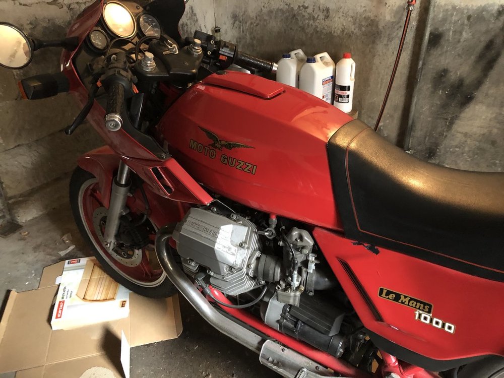

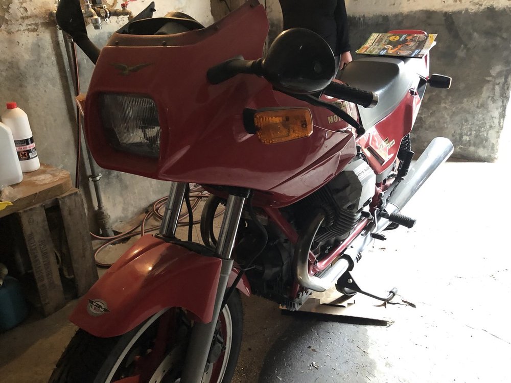

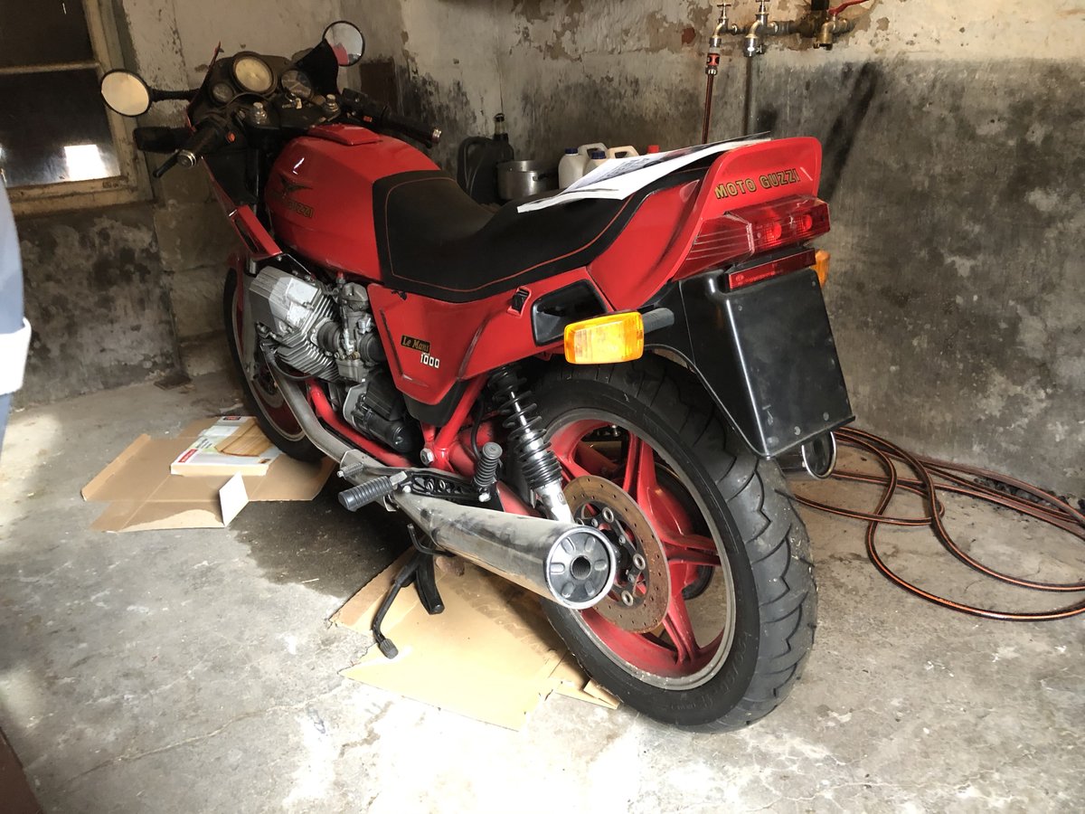

flexi61 Posted July 16, 2020 Author Share Posted July 16, 2020 So habe ich sie vorgefunden: Quote Link to comment Share on other sites More sharing options...
